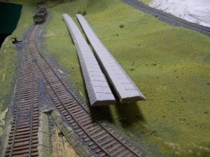

Homasote is an excellent roadbed material. There is a product called "Homabed" which I used on my layout starting ober 20 years ago. I used it dorectly on top of the plywood handlaying my code 70 track. It is a great product and I have not had a single problem with it in all the years it has been down. The Homabed is a quarter of an in thick and has beveled edges with slits cut into the edges to all easy placement for curves. When ballasted these slits dissappear. I would recommend this product to anyone.
I would definitely not use the homasote support itself. My layout benchwork is quite similar. Depending on where you are, humidity could effect the homasote. Using the homabed directly on the plywood will have the strength and being that it is glued to the plywood will not warp or bend.
