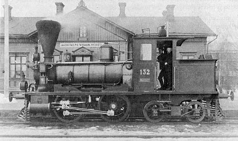

Look what another fellow came up with,..
https://en.wikipedia.org/wiki/Forney_locomotive
Very interesting as to why this wheel arrangement
The locomotives were set up to run cab (or bunker) first, effectively as a 4-4-0.......
