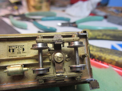

K-27's look awesome going down the track as they sit so low. I had DCC w/sound installed in my United K-27. The speaker is in the tender, plenty loud enough to hear without holes being drilled in the bottom.
Any idea how the tender can come apart? I don't want to de solder anything (It's nicely painted)
Dave: Thank you for the info! I have made a 3D copy of this tender which I will probably use with my old Roundhouse 2-8-0 as I don't see a way to get that tender apart either. I did see those two screws but was hesitant to detach something internally by accident.

From what I see there are two screws, one next to each truck. According to notes from the installer regarding the tender, he removed half the weight that was originally in the tender, installed a 13x16 speaker, a keep alive circuit, extra pickup wipers and a rear SMT LED in the tender light.
