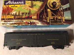

This is Athearn Blue Box (remember them?) item #5330, an express reefer used in head end passenger service, done up as SLSF 5073, used as a head end car in Frisco passenger service. This was an undec Athearn kit, decorated by me using Champ's excellent duluxe gold decals. The car has express trucks with Kadee metal wheels, Cal Scale brake hoses, Cal Scale passenger steam and signal lines, and Kadee couplers.

Thanks much! I'm going to try the Athearn #53308 Express Reefer trucks, which appear to be what you have, and I'm sure they'll do fine. The car I'm working on is not unlike what you have there. You did a great job with it.

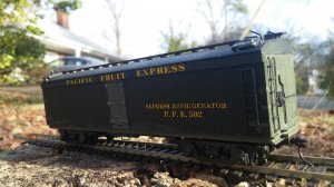

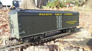

Here's what I ended up with for this car. Micro Motive express reefer trucks and McHenry couplers.....

Thanks, Alan. That's why I left the corner steps off for now, and even the coupler pockets may be a problem. Someday I'll have room to build a layout and will find out what radius she can work on! In the meantime I occupy myself building these kits. Now midway through a La Belle HO-49 gondola.
