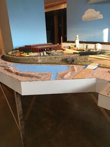

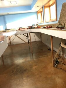

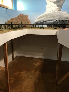

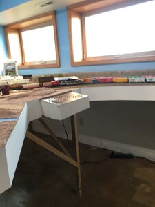

I just installed my facia using five inch strips of 1/8 inch tempered hardboard. It will bend around curves if they are not too sharp. It paints up nicely too.
