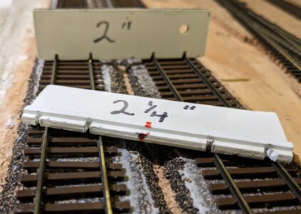

Standard is 2.6" in both HO and OO, simplest way to maintain track separation is to use a gauge like this, Sorry @Hutch no clue if it will fit on a WS incline.
I believe Mike is correct, you’ll need a wider base on the risers.
A track spacer is easy to make with scrap wood, styrene, or what have you.
I made these from Styrene, two inch centers for tangent track (the distance of two turnouts in a crossover) and two and a quarter inch centers for broad curves.
Two point six inch centers as mentioned works better for tighter radius. 👍
I’ve done 2” and 2 1/2. 👍
That looks like a real easy way to make the jig. Thanks
