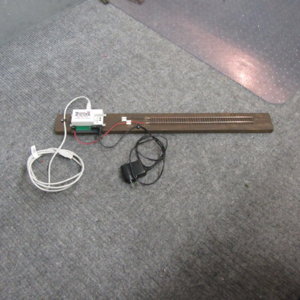

Mark:
Here's what I use and constructed to put in front of computer keyboard. It stores out of the way and just plugs into the computer and a power supply. It can read and read the CV's of most decoders and also downloads sound files into Digitrax sound decoders.
Click on the photograph for more detail.
It's Digitrax PR4 system for about $80.00, with a piece of track and a two foot 1x4.
Greg
Greg, You must have the PR 3, as I see a separate power unit. With the PR 4 I have coming, The power unit is included in the PR 4.
