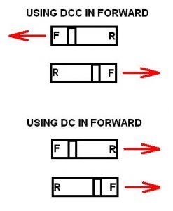

Not with DCC. There is no "track direction" with DCC. If you are running left to right in forward. then pick that engine up and turn it around, you would then be running forward right to left without doing anything on your throttle.
Unless this is just your personal preference in that left to right is forward .... so what do you do if your engine is FACING to the left ? To run the engine in reverse, you press forward ? Sounds awfully confusing to me ....

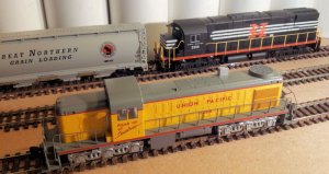

Example using this picture of yours. In the picture, the UP RSC-2 should be moving to the right when in forward. The C-425 should be moving to the left when in forward ....

Hmmm... will have a play with them tomorrow. I guess it is because I have been running European trains for so long, and they have cabs at both ends, so front and back are not so important. I just used to look which end had the headlights on to see which way it would go!
Just started using US locos on DCC, so guess I have to think differently. Several more locos to fit with decoders, so will pay attention when doing so. Thanks for the input :)
