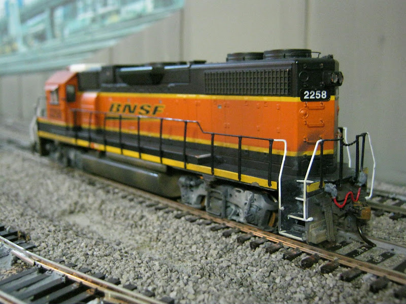

I just got a new airbrush last week. So I decided to go for it on a new loco.
It's an Athearn RTR GP38-2. I picked up some details west parts. (it didn't even come with a plow).
Let me know how I did?

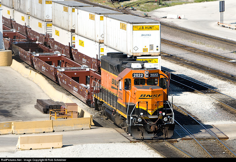

This is the prototype look I was shooting for

It looks good to me also.
Is that a kink in the track at the rail joiner in the lower left of image 4 or just an illusion because of shallow depth of field?
Fine job of detailing. I've done a couple of those RTR GP-88's and there's a lot of detail to be added. The only suggestion I would make is use a fine point black marker and replicate the vent holes in the A/C unit on the roof. The prototype shows a two unit install, but I don't know if that was common to all the locomotives in that class. As it is now, the A/C unit is kind of a white blob, so some steady hands with a marker whould spruce it up some.
No kink in the trackwork, just looks that way.
I made some minor adjustments. With the A/C unit, just hit it with a little bit of weathered black.

Looks pretty good, the only things that jump out at me are the prototype doesn't have the class/marker lights on the nose like the Athearn unit has, and the prototype has some round thing on the side of the short hood. If you're going to go through the trouble to replace the ac unit you might want to look into fixing those two areas as well. Other than that it looks pretty good, sorry if I came off as nitpicking :)
That "round thing" is a round cab vent, Detail Associates makes a good one, plus you'll get 10 in a pack, so you can save the rest for future units.
I suspect that one there is venting the toilet...
