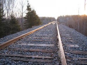

Hi Steve--On an old Soo Line bridge in Northern Wisconsin they just curved the ends of some old track ("called guard rails above) and spiked them the ties several inches inside of the rail. The one I looked at was quite long. I have a good photo if I can find it.

Here is the photo:
Nice, thank you. Just need to figure out what to use to make them. Have some scrap flex track so I may try that first.

If my memory serves me it seems the guard rails were a slightly smaller gauge. Hard to tell from the photo. I know it was some pretty beat up track.
Believe it or not, I walked the trestle. You could see the rushing river seemed like 150' below the open ties. lasm
I have seen prototype guard rails where the ends touched like those shown in the photo, but also where the ends didn't quite touch. Because of the danger of short circuits, I would leave the ends of the guard rails slightly separated, or form the joint with plastic, etc. As a matter of fact you could probably make some from plastic forms. The idea of guard rails is to keep derailed trucks from going so far off the main rails that the rolling stock could impact the bridge structure.
if you use metal rail, go at least 1 size smaller than your main rail. sometimes the loco will catch the guardrail. also, leave a gap inbetween the two ends. it can cause a short if the wheels make contact, but the real problem comes with the coupler trip pins. if you have one hanging a little low and the ends of the guardrail are in a "V", the trip pin can grab the rail and follow it causing a mess.
