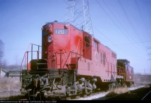

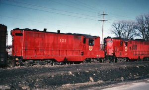

Chicago Great Western GP-7 Color match
Can't help you with the exact color match, but this link will give you some nice photos and background info.
http://www.rrpicturearchives.net/locoPicture.aspx?id=38983
A better photograph:
Note: This link "CGW Paint Schemes) simply calls the color "red": http://www.trainweb.org/cgw/history-bin/cgw_diesel paint.html
This photo from the above website, not dated

Thanks for the information. After seeing the photos,what do you think about caboose red and a couple drops of maroon. Any suggestions on a do it yourself match. I have a Badger color chart to work with. Lots of red paint on the chart to deal with. Thanks John
I notice that the shade changed over time, so I guess there is some leeway as to new out of the paint shop or faded a little. One link indicated the date each photo was taken.
Not to sound sexist, but my wife is way better at this stuff, getting the right shade. If you have one, make up a few samples and let her decide?
lasm
How do you intend to paint the engine, with an air brush or by hand? If you are going to spray then try Tru Color as they have paints specific to rail roads.
