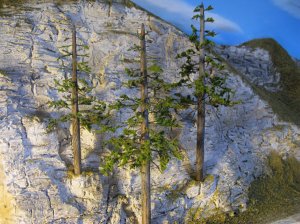

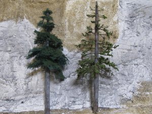

In the photo you will see my two choices of trees. I don't want to combine them on the layout because in SE Alaska conifers tend to be all one species where I'm modeling. I'm leaning toward the Caspia tree on the right. Any thoughts? Jim
Thanks guys. Yes, I think I like the right one as well. Just went and bought two Caspia bundles today. I also got some 3/8" and 7/16" dowels. I been using raw umber for the trunk with a light treatment of gray. "Bark" is made by my old small handsaw carving down the dowel.

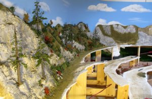

Got some more work done. The photo shows some ground covers, bushes and some trees. As you can see because of 'reach' issues I have to build the layout back to front. Some plusses: As I go around I can evaluate the last section and make improvements on the next segment. Negs: Doing the part near the back drop is done on a 2-step stool. Only way. Sore back.
When the upper part you see is finished all the way round the room, about 26 feet, I will start on the left again and do the middle section. This includes track. So I can't run trains all over the layout before scenery as I build a bit different from the norm. Jim

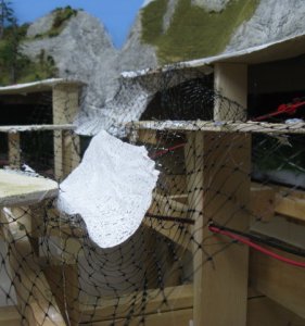

Here is the beginning of the Pinnacle Creek itself. The plastic mesh and some plaster cloth. In the background you can see the top of the creek. All the gray rock is the Stucco Patch product. The mesh holds it quite well. Also some more ground cover. Remember I build back to front becaues of reach issues in the corners especially. You can also see the wiring for the DCC. #12 bus wire with #16 feeders. I'm new to DCC and I will be happy to get my locos back from the fellow installing my chips. Jim

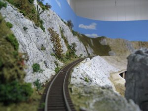

Getting some track, Atlas Code 83, laid on the upper level. "Planting" on the rocks continues. Also blurred and to the right front is the pinnacle that gives the layout its name. Jim

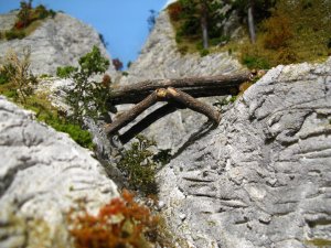

Upper bridge on Pinnacle Creek. Logs were used because on the Alaskan Panhandle trees were plentiful. On this layout in 1931 miners and loggers were pretty much on their own and had to build using local resourses. Jim

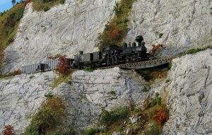

As promised here is a photo of the flatcar bridge. Flatcars where used for decades back in the day on these types of lumber and mining sites.
You can see some of the foliage being added. No trees around this part yet. Remember because of reach issues I do the layout back to front. This photo represents the higher parts of the layout and in keeping with higher elevations the shrubs, plants, ground covers, and even trees are not quite as detailed as they will be in the front of the layout. While I do not subscribe to the 3 ft. rule the lesser detail in the rear of the layout represents the actual loss of visual acuity you experience in the prototypical world. Jim
