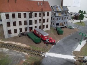

Woodlend Scenics does have a road kit, but here's an alternative. I wanted a larger town on my layout. I used cheap styrene "For Sale" signs. For the main street, I painted the back a concrete color and used a gray primer for asphalt side streets. I had never seen anything like this but figured it would be worth a try.
attachment.php
Once the "streets" were down, I used a fine pencil to draw ing the seams in the concrete street and chalk for the oily streak commonly seen in the center of the driving lane. For city blocks and sidewalks I found a slight thicker "For Sale" sign and used it for the base of city blocks and cit strips for sidewalks in the residential area on the edge of town.
attachment.php
The material was cheap and even though it was an experiment, I am more than happy with the results.

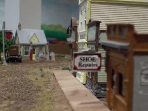

I used a couple different things for my roads, in the village I went with trowelling on sheet rock compound and sponging with a water/black acrylic mixture, also used the sheet rock compound for the sidewalk; This picture gives you a rough idea, though the colors don't really show true in the shot:
For gravel I sift some road aggregate into a couple different sizes, the coarser one for the road and a little finer along the sidewalk:

"For gravel I sift some road aggregate into a couple different sizes, the coarser one for the road and a little finer along the sidewalk:"
The "gravel" looks more like small boulders vs dirt. Suggest you put a scale figure on it to see if a person could actually walk on it. I.e. would you walk on it? >)

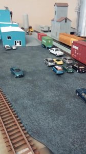

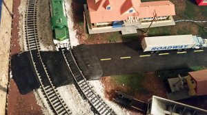

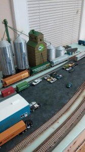

Today I went into an arts and crafts store to try and locate some EVA foam that Steve S demonstrated on page 1 of this thread. I found and bought 10 sheets 12"x18". I must say I like it.
