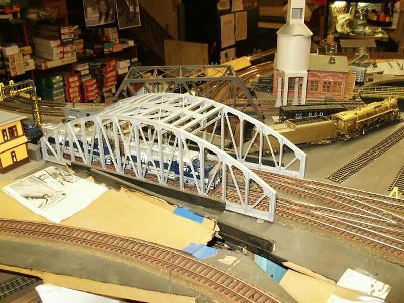

Seems I'm not the first with that thought, either:
