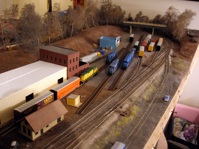

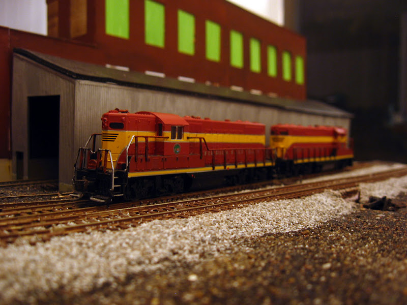

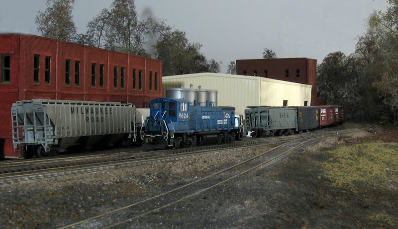

As for pics, I'll defer to my friend Ed's layout since his is further along.
