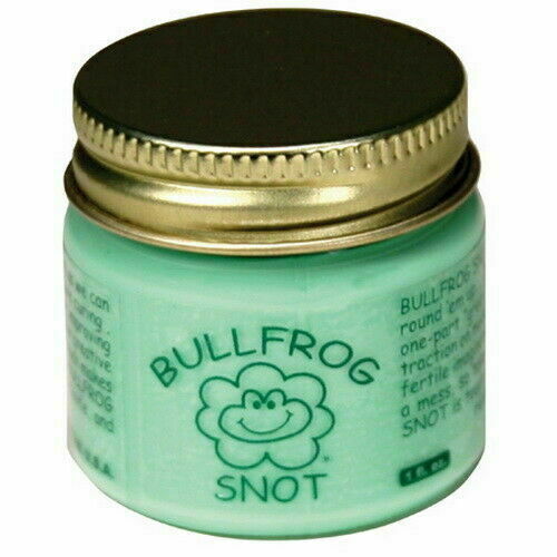

Someone mention the goop you can put on the wheels to add traction. I believe he was referring to "Frog Snot" which can be applied to the bearing surface of wheels. Once dried, it's like a thin rubber tire that acts like a traditional traction tire.

The goop your referring to is Bull Frog Snot, available in the US. This is a US seller but most model train stores will probably have.
