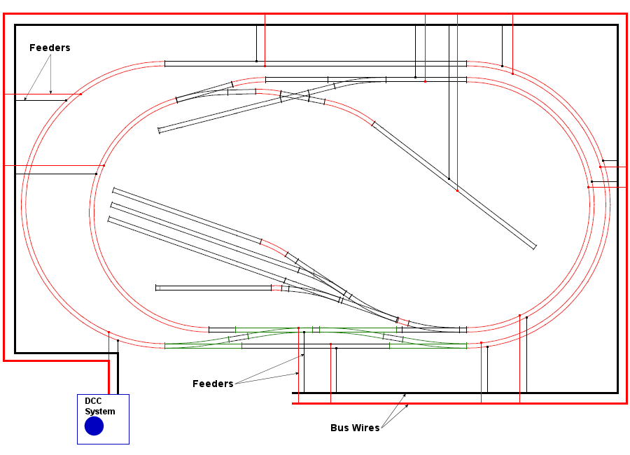

Most large model railroads use a system of Bus Wires and Feeders to distribute power around the layout. Bus Wires are heavy guage wires that run the length or perimeter of the layout. Feeders are short, lighter guage wires that connect from the Bus Wires to the track at intervals such that no part of the track is more than a few feet from a Feeder.
An incomplete diagram of this arrangement for a DCC layout appears below.
Not all of the Feeders are shown, but I there are enough to give you the idea. The Feeders are attached to the Bus Wires at one end and to the track rails at the other. Most of the time this is done by soldering.
