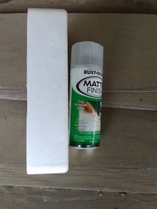

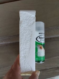

Hold the phone guess what I just found , I have a can of Rustoleam Matte Finish I purchased to coat a custom lettered keyboard , I spayed it on some Styrofoam and it chewed up pretty good , will post pics later. Must eat now.
Heres the Pics , I shot it few inches away. I didnt overly saturate it. So test before you use.
