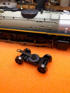

Take the front (pilot) truck off and run it. If its fine then you have to much down pressure on the pilot truck bar. They bend easy, just bend it so its not supporting any of the weight of the loco. It should basically just float on its own weight and the loco should push it along. Ive had to add weight to all Bachmann front trucks to keep them from derailing. Here is a photo with two washers attached to the front truck and painted black. Works perfectly and the locos can easily do 18" radius now. I also remove the shells on these and put 2 or more oz of stick on weights under the shell over the drivers. Turns these cheap Bachmann steamers into something that can actually pull more than 5 cars. LOL
