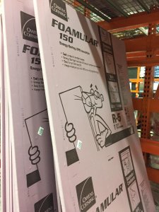

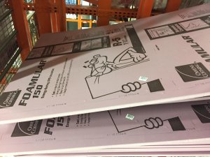

Checked out Home Depot on the way home tonight and found some 1" extruded foam board. The pink stuff looks more purple to me. I also noticed it was scored in back for breaking off pieces.
Has anyone placed a propane torch to this to shape it? Seen a few Youtube videos that do it but it was blue foam.

I haven't heard of anyone using a torch on it. I would be concerned about the fumes. As far as the 1" foam goes, I would recommend getting it in 2" thick if you can. Less gluing. And I don't recall just where I saw it, but someone posted a video of a woman doing a glue test on pink foam board, using several different products to test adhesion. The winner? Glidden Gripper paint primer. And you can get it at Home Depot.

I have heard of people using a torch on the extruded foam to make rivers, personally I like to lay scrap plywood as the base of the river and build up the banks.

I'd like to get the 2" foam board but Lowes only carries the green 1/2" and Home Depot only carries the pink in 1/2" and one inch. :( Good to know about the paint.

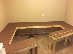

Here is the bench painted brown. Supposedly that helps hide the wood better when flocking is put on it.

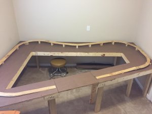

Been busy for a while but I finally got some time this past Saturday. I had layed out some track to run the train for my grandson when he came to visit the other week but I pulled it back up do I could do some work on the bench. Learned a few things along the way. When using flex track, keep the movable rail to the inside of the curve, don't connect tracks in the middle of a curve, and use Atlas track connectors instead of the micro engineering ones. Also discovered that horn couplers and knuckle couplers don't couple. Did get one coupler to work with the knuckle so I connected all the other cars to it. Had one car that kept jumping the track in one area in a curve and I think its because the car is longer than the rest and the coupler may be to short.

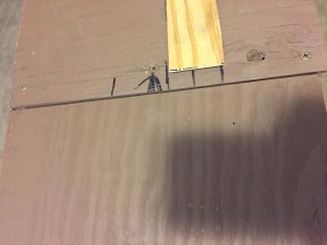

Over all it was fun to play with. Here is the elevated/grade subbed I made. It took longer than I expected but I think it turned out ok. I'm planning on laying track on the inner side and have it go under the highest part in back.
I also did some work on the bench and gate. There was about a 3/4" twist between the gate and the benchwork to the right. Turned out the cross pieces of the frame was torquing the bench top so I removed them, re assembled the benchwork, then re installed the cross pieces. Much better!
