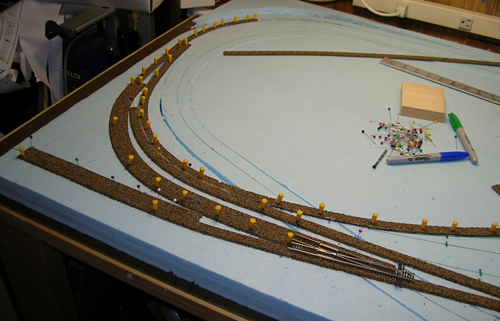

Using pins is the best way to secure the cork while the adhesive cures. You don't need T-pins; any pins will do. I used a combination of whatever pins we had in the house, as shown below.
- Jeff
