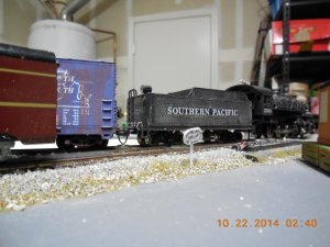

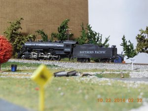

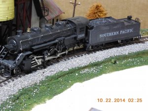

Well I put the decals on the locomotive, so I thought I would put a few pics of how it turned out. I think it came out ok, not perfect but I have them on and have some experience with this now. Thanks for all the help.
Scott
