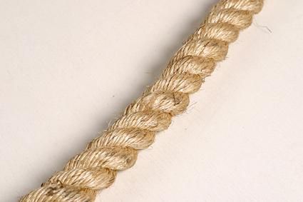

I use old rope bits. Not the yellow poly stuff or the white nylon stuff, just old fashioned fibrous rope. Its a kind of dead grass colour. Just cut off various lengths and glue down as is. Works and looks great! Sorry no pics right now - I'm just starting my first layout in 16 years. Time to re-learn a lot of things - especially how massively expensive this hobby can be!! It's no wonder I've always used scraps of whatever for scenicking and scratchbuilding.
EDIT: I did a search and it is called Manila rope. It is a traditional natural fibre 3-strand rope and really does a nice job, but if you want greener wild grass, you may want to dye or stain it to taste.
Just un twist it and have at 'er. A few feet will last you years if not a lifetime.
