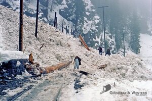

I'm working on installing my snowshed, and since I'm modeling spring, I'm planning to have a small avalanche on top of it - a chunky, kind of dirty one just like in the image attached. Any ideas?
