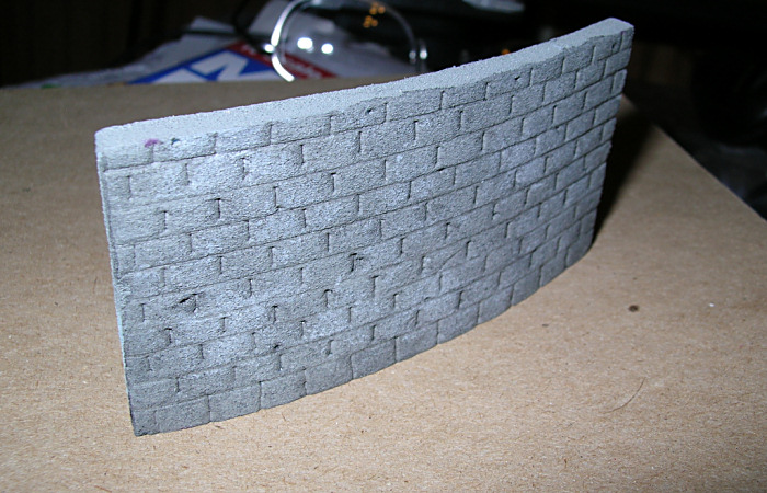

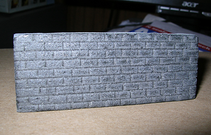

For REALLY cheap retaining walls, you could try something like this.
This is a piece of 0.25-inch blue foam. I created the pattern of "blocks" by pressing on the foam with a metal straightedge and a flat blade screwdriver. Then I applied gray acrylic paint, then a few washes of thinned black acrylic to emphasize the texture.
With additional weathering, I think this technique will be good enough for my layout. As a bonus, it is extremely simple to do.

Now that's way cool!

Thanks for all the help. I would have never guessed that that retaining wall was foam! Definitely going to try that.

Thanks, guys. What I like best about the foam retaining wall is that you can cut them to the exact size and shape you need. You can even make them curved.
