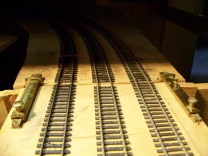

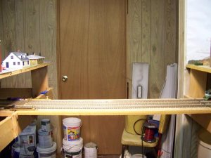

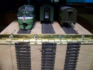

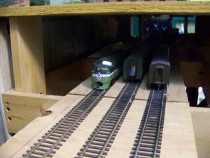

Here you go Skip, here's the Polish engineering bridge. The bridge itself is 5/8 plywood. That's what I had on hand while building the layout. It was going to be temporary when it was put in about 25 years ago, but it has been working just fine for all these years so it stayed. If it ain't broke, DON'T FIX IT.
Bridge 001.jpg Here it is in the up position. Click on the picture to enlarge it if you want. These tracks are for my hidden staging area.

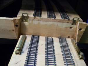

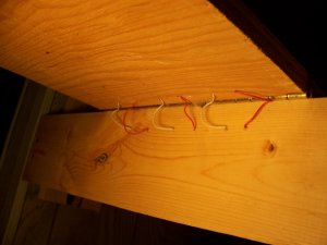

These two pictures show the hinged end. There will not be any allignment problems on this end. Feeder wires for power are in the next picture. they were just soldered to the corresponding rails.
For the other end, I used a couple of cabinet slid bolts to lock the bridge in place when it is up. Once the flex track was installed on the bridge part of the layout, the bridge was left up and I used a couple of scraps of plywood installed at a slight angle to make sure that the tracks would align.

Here are the last two photos. You can see in the second photo where the scraps of plywood will keep the tracks at the open end aligned.
If you are worried about warping, you could tack and glue a couple of 2 inch pieces of masonite to the side of the bridge on the upper side which would also act as a guardrail.
Like I said, it was going to be temporary until I came up with something better, but it ended up not having to be improved for my purposes. It ain't pretty, but it is functional.

Also looks like the tricky part is lining up the hinges?
And something that confuses me is that when I look at the photo showing the wiring underneath
I don't see any hinges where I expected to see them?
Skip
The hinge is called a piano hinge. Look at the first picture and you'll see that the hinge faces will be facing each other when the bridge is in the up position.

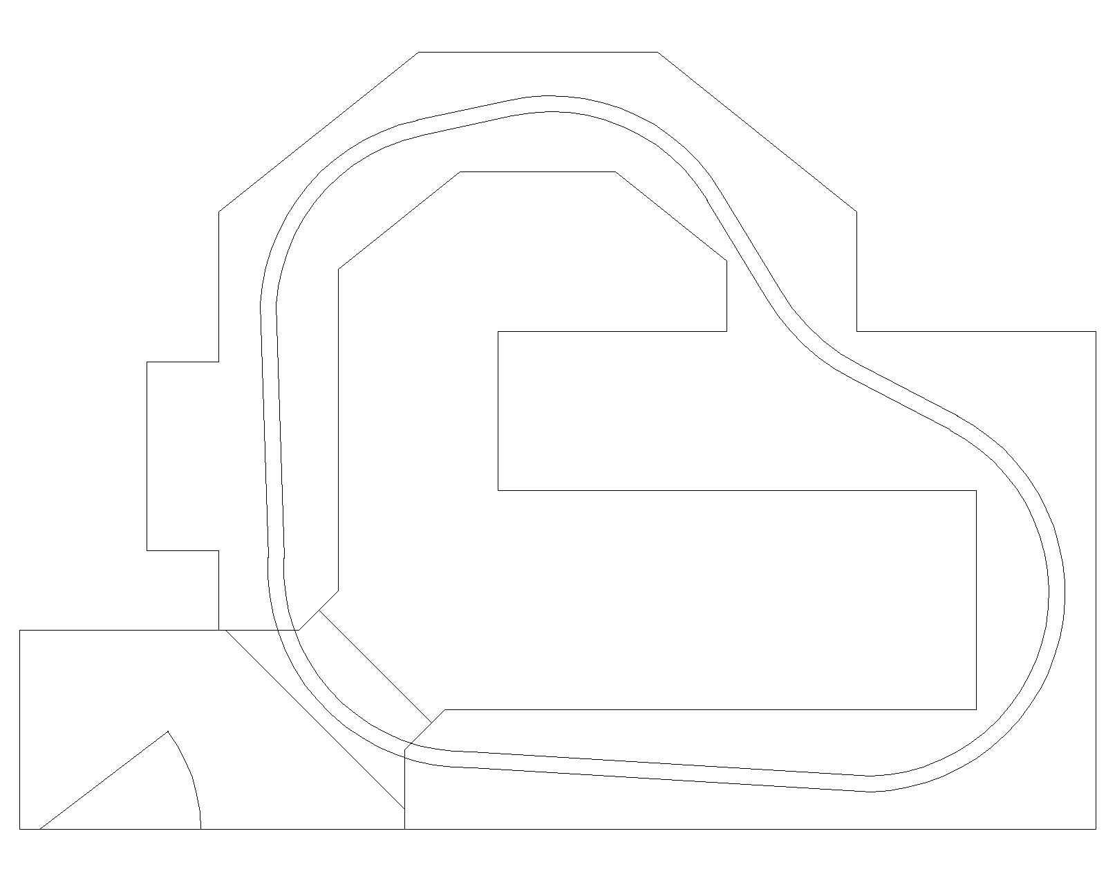

I drew up your room in autocad and tried to layout a folded dog bone. There is really not enough room to do it. I agree with Montanan that a shelf layout around the perimeter is your best solution.

When you say there's not enough room, I'm curious about this... When I measured the room it appeared to me to fit two 22" radius loops at the widest part's sides while still leaving an 18-20" pass thru to the room's center? I'm not at all familiar with autocad, but does it work on the parameters one enters? If so do you think two dog bone loops might work if you entered something that said use a maximum 22" radius? I know this would probably use up more room space, but then it might also allow some yard storage in the center of the loops?

I used a 28" minimum radii on the plan. When I try to draw the dogbone style layout you end up needing almost solid bench work on either end of the room. This creates bad reach issues. It can be done but will not be ideal.

Thank you Steve... So if I go with a minimum 22" radius I believe that would probably give me enough room to navigate in the center of the room between the two reverse loops? And then at that it should only be tight in the one spot, as the rest of the layout would be shelf-like, around the room.
If you have the time, I'd be very interested to see what your CAD dogbone design for my available room might look like in the smaller radius's? I'm really trying to keep this layout very simple {and very quick and easy}, and I would appreciate it if you would use your CAD skills to show how much empty center space I would get with less wide curves?.

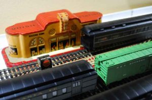

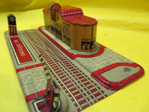

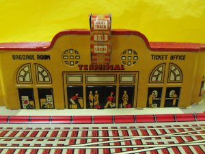

My thinking about HO layouts might startle some MRR magazine-reading folks, as I'm not looking to emulate a realistic looking miniature world but am instead very much into "toy stuff" even with HO? My initial plywood platform coverings will probably be indoor-outdoor green carpeting with black rubber roadbeds under code 100 flextrack, and my train stations are some lovely (IMO anyway) Marx lithographed tin ones that are (mistakenly?) more HO size than 027. In my HO world I'm mixing the highly detailed HO locos and rolling stock that I love with some toy surroundings, in much the same way I like to mix my impressionist Marx 027 toy trains with some realistic surroundings. {I've attached a photo that shows some beautiful HO Atlas ATSF heavyweight varnish standing in front of a Marx tin station so you can see what I like...;>})
