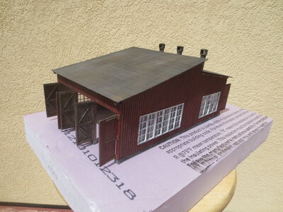

This is a custom/kitbash for the Sonoma Mountain RR layout. It's a Timberline 3 stall engine house kit that had to be modified to fit a specific 3 track space next to the turntable on the SMRR layout. The original square exhaust stacks were replaced with custom made round stacks. The corrugated shed is an add-on the owner requested. Door hinges and nut/bolt details were add-ons. The large roof side was done 5 times due to warping issues after applying the tarpaper material. I ended up cutting the metal case/cover from a VCR to use as the roof and using a different brand of tarpaper. Although too late for this build I did get a roll of Suretape CP743 that I will use next time for tarpaper roof work. Both sides of the roof are removable for viewing the future interior. The hardest part was building the windows! I can't say how many times my fingers accidently poked through breaking the mullions. There is hardly any adhesive on those small parts! I have a few touch-up areas then I have to ship it to the owner. Wish me luck on shipping!

Your persistence with the roof paid off. Looks great!
Never heard of Suretape. Looks interesting.
Nice job on the build.
Those windows look great!
Very nice work indeed on the engine house. Details really make a stand out model.

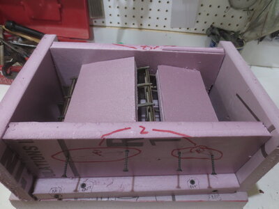

I built a foam vault around it for shipping. I'm waiting to hear if it made the trip with UPS to CA.
I am always worried about shipping delicate stuff, looks like you came up with a good solution!
I secured all of the removable components with the extruded foam and deck screws. It kind of turned out like a puzzle.
