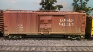

Wood sheathed cars with steel underframes were made up through the 1920's and then again around the 1940's (WWII). A freight car was good for 40 years without rebuilding so a car made in 1925 would be good through 1965 at least. The key is whether it had a steel or truss rod underframe. Steel underframe its an older car probably not a class A car, probably not for shipments that require a clean, watertight, no holes in the floor shipment. The LVR car is based on a Great Northern car that was a steel car sheathed with wood to show the GN lumber industry customers the GN supported them. You can see the tips of the steel truss in the car walls projecting under the sheathing onto the car side sills. the 10'6" inside height pegs it as a "modern" 40 ft boxcar. The Depression era USRA cars would be 9'-10' IH cars.
