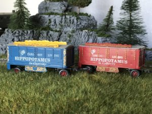

Here's my take on the Hippo wagon by Walther's.
Hey Johnny, looks amazing! Could you tell me how you did the chain, the ring on the corner of the wagon and 3-D skyboard and lower scrolling? Much improved appearance over mine!
CHAIN; I used small chain and twisted a small(hairlike) wire through it like you would tie a loaf of bread. this gave me a tightly twisted wire that I could insert into a hole drilled by a No.77 twist drill bit. I did this on both sides to hold the tongue up. CORNER RINGS; They are made the same way you do the chain only you use a 3mm jump ring found in Michaels or Hobby Lobby. Again drill a No.77 hole and insert the wire into it. SCROLLS; The scrolls are made from scroll work I've collected through the years from other models or long out of production pieces.

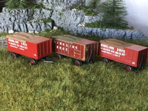

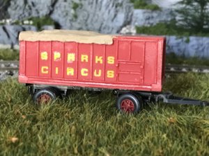

In response to Joe's stake and chain wagon, here is how I did mine. I mounted the wagon on a truck and added the tie downs. The tie downs are made by drilling for and placing eye bolts along the bottom to tie the 'rope' to. I then drilled holes into the canvas to insert the other end of rope and acc'ed the rope.
