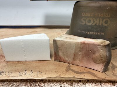

These 4 containers are now client approved. The request was Side panels with just dusty grime, end panels heavier splatter but not real strong. Then after 1st pictures, he asked for more grime! I purchased 12 of these at the Athearn 60% sale in February. I have a intermodal modeler as my best weathering client. He saw the containers and asked if we could deal on 4?
Brushed on as a wash 30% Vallejo dirt to 70% distilled water and then after they were dry, the weathering was removed (91%IPA) using a clean makeup sponge in a dabbing motion. Based on photos sent by the client for inspiration these 4 are much cleaner than the pictures taken in 2021.

The blue Pacer cars were faded with just a normal fade mix of 20% Tamiya xf2 white and 80% Isopropyl Alcohol the 91% concentration. These were hit 3 times to where it feels and looks right. I did take some iron oxide pigment and apply it to the metal lattice flooring but took no pictures of it!

The blue Kato Pacer set like the 2 sets before it was basically just faded. Tamiya xf-2 white thinned with Isopropyl Alcohol. Inside the car was Vallejo pigments iron rust. Followed up wash of Mission Models NATO black.
thinned 10% black to 90% tap water plus 5 drops of VMS matte clear varnish. The black wash sealed the pigments. All other clear coating on this set is the Mission Models Matt clear.
The 2 sets of Walthers 5 car sets were next up. i sprayed the entire car sets with Tamiya Flat Earth color after washing and letting the cars dry
I then added a VMS GLOSS coat applied to the side panels via air brush. I grabbed the Mission Models NATO Black and made a PIN wash. A 50/50 mix of NATO Black and tap water. I applied this wash on the side ribs only letting the wash run down the ribs creating dark shadows along the ribs. After Drying I sprayed VMS matte clear varnish over the entire car. After the VMS matte clear varnish dried the side panels of this set has 2 coats of Vallejo Air Dirt applied as a wash and is currently drying
