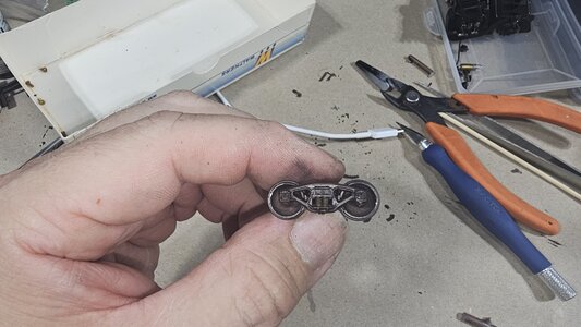

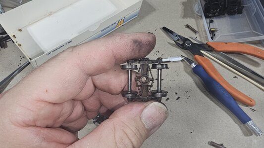

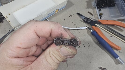

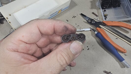

By the way, below are photos of the reworking of the weathering of the trucks, wheels & turnbuckles since my last post:

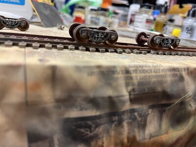

Yep that's how I do mine. The track you see is my wheel/ truck spray track. I roll them back and forth and spray the wheels holding them with tweezers. Then hold the trucks and spray them. The last spray is with grimy black (3 previous are rust, earth,and light rust) again on the track so the wheel are rolling to get an even spray but, the wheels do not get targeted it's just an over spray from doing the trucks, but by rolling then you don't get spots.IMG_6293.jpg
