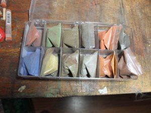

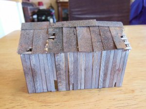

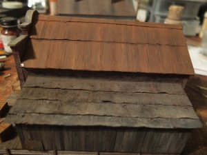

I've used etchant with great success. I've also used paint with Bragdon weathering powders.I think rusted roofs are a personal preference as well there really tough to take a photo of what they actually look like. DSCN0598.jpgkitforum rusty roof 1.JPGS0803243.jpg

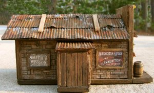

I've used the same metal corrugated sheets on some of my buildings, and I've always brush painted mine. I find if you add some dirt to the paint, you can get a textured rust look. Here's a pic of my O scale Gunsmith Shop.
D.A.
