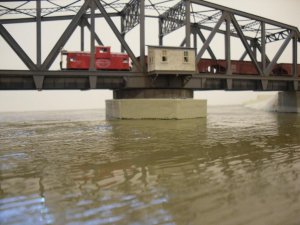

I did that once with glass from a shower door, same as a patio table top.
Looked pretty good actually.
I painted right on some rough surface plywood which came out looking like ripples also.
The paint I used was matched to a photo at the local hardware store.
