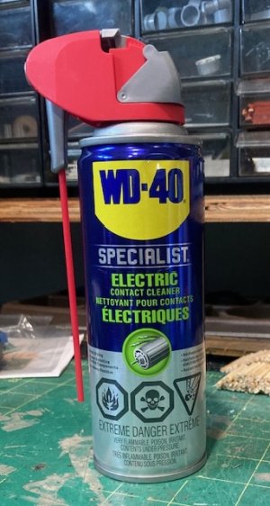

Well I just ran out of my regular cleaning fluid today so I started looking at alternatives.
I never thought of trying WD-40 before but according to the list below it’s actually far less polar than what I’ve been using thus far.
Much to my surprise it actually took gunk off my locomotive wheels that I had just cleaned previously!
So far I see no evidence of residue left behind on the rails so if this works out woohoo!
Has anyone else tried this?
