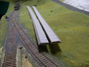

The Homabed I bought was milled. It is almost shaped the same as cork roadbed. It has a 45 or so degree angle on one side like the cork, but in the center, it has cuts from the center so it is easier to bend into curves. I am not home now, but when I get a chance, I will take and post a few photos. It can be bought by the foot, not in sheets.

Go to www.homabed.com. They have pictures of the final milled product. It is competative with cord roadbed. I had bought mine tears and years ago, but they are still in business. When I bought mine, I think it was a one man operation doing the milling. No more waste than using cork, but a better product as far as I am concerned. Here are some pictures. You can buy it by the foot and although I haven't had to price any roadbedin years, it is competative with other products on the market. It is all milled and cut, ready to use.
