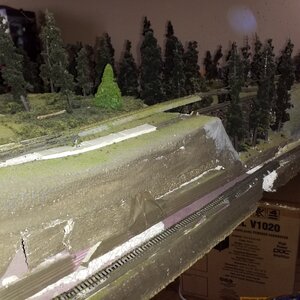

Back to the layout/ I haven't done anything with the layout at all. My hands ache and shake so much i cannot finish the steam engines, so i went and bought 2 NW-2's and 2 RS-2's as well. The NW-2s are sound as well. All dcc. After letting my layout sit and collect dust its been a headache just to get the main line working. I had to replace some pieces so it was smooth enough to let me run sound. My upper level is all messed up. The track came up off the board 1 1/2" off the board. It damaged the newer long trestle i had made a couple of years ago. I have fixed the trestle but still don't know why the track raised up like it did. I am not doing anything more to that part of the layout till i can figure out what happened and fix it right. I just hope i don't have to tear that part down. I have a couple of pictures to show of that bad area and a You Tube of one of those NW-2 with sound on. Now if i can remember how to post them. Will try to be on here more often. I have been staying on another channel, my hands hurt so much. anyway thats all for now.

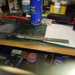

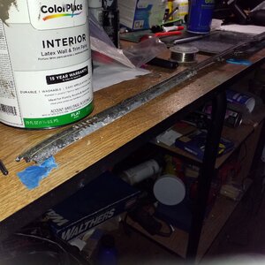

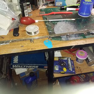

So, From a few of you out there. One said unsolder all as it don't allow for expansion/ contraction. Another said unsolder and put new railjoiners on them. SO..I unsolder all the track but one end of the bridge to a piece of Kato track. It really had a good solid solder joint. The other pieces are now unsoldered and new jointers in place of those soldered jointsout of 5 pieces of track 4 are now unsoldered. So i guess i will see how this works out. Later all. Some shots of that fix on my workshop desk. Desk is messy, o well..

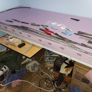

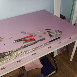

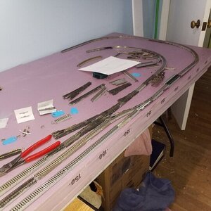

Well, After 8 years of trying to make the plan work i have given up on it. I stripped the mountains of anything and the valleys I trimmed the foam off from the housing and lumber yard. I saved the bridges and track. I bought two sheets of Pink foam. One of the main reasons i was having issues was the white beaded foam. It was breaking down after all the time i was trying to do the layout. So i have a 32 inch X 96 inches table. Its one of those hard plastic models that Wally World sales. Its one of the heaver ones I cut the foam to 32 inches and glued the two pieces of foam together. So far no warp or the two pieces coming apart. I used Power Grab to glue them together. Worked pretty good. So i have a SCARM Plan that was going to try, but i ran into issues with that plan and changed it a couple of times and then again. Scarm gets me close but not perfect so anyone using it should allow for different track company sizes. I am using Kato so not sure why it wouldn't work but i had to make a few changes to make my plan work. I redesigned a new yard for the lumber ladder track and am also working on a new logging camp.. More on that later. The black colored track is coal or cinders from the last layout. I washed all the track but couldn't get all the black off so I'll clean it up later. A couple of shots if they don't need to be resized. Having issues with Firefox so i will see. See you laters, Smoke

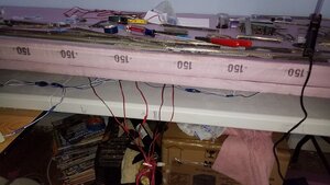

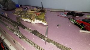

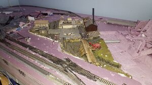

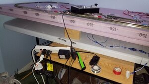

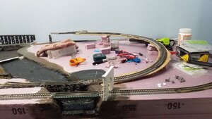

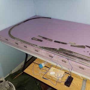

Have the track all wired up and ready to use low temp glue gun to hold the track down. With a bit of fun, I could have track clean and running some engines on it to see if there is anything wrong with it. I wired all the turnouts and they are numbered. the power connectors are new run down the underside of the layout use butt connectors and taped it all together to make it neat. Starting to look like a train layout. I am putting photos of it and the mess.

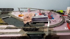

Well, ran into too issues. I need to change the #6 to a #4 rh at the sawmill and i will have to dig deep to set the sawmill up again. Same for the river. Hows my luck, i have 3 #4's LH and no RH. Have the rest of the main line done and my RS-2's from Atlas seem to like it. Same for the NW2's from Broadway. My little 43 ton yard switcher shorted out and fried the dcc so i have to send it to Bachmann for repairs. Don't know what but i saw smoke and a little orange glow from the cab area. I pulled it off the track and i can smell smoke from it. I am getting ready to start cutting out the river. Some shots below, Smoke

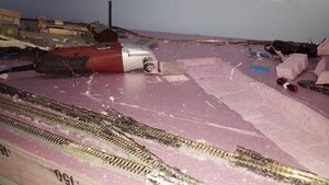

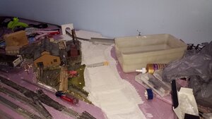

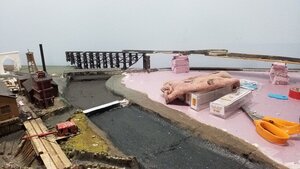

Started working on the river this evening. I got about half of it done so far. this isn't any easier or cleaner with pink. tomorrow is another day.

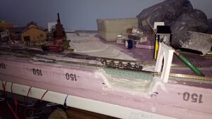

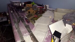

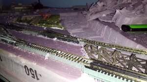

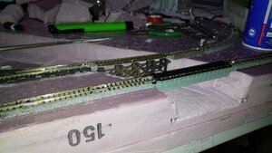

Got most of the river done in rough, and got the bridges both roughed in. Dug out enough of the pink to place the old moat for the sawmill in place. Thinking of taking a day off and r&r. Shots below.

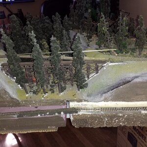

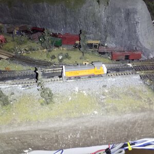

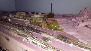

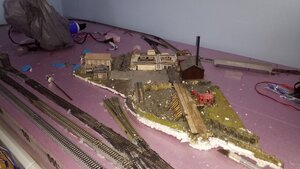

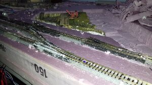

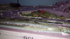

Did really little to my section other than shim the sawmill section. It has some minor damage but sit pretty good. Thats one section thats pretty much done and one more i kept is the town itself. I will get that maybe next. I want to clean it up before i start running anything and or finishing the river. Pics below.

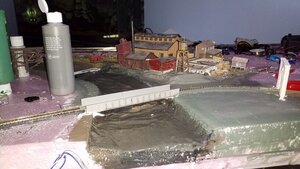

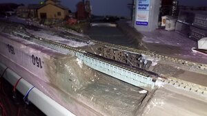

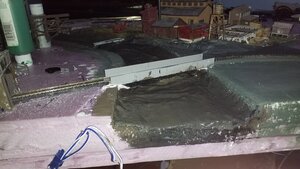

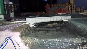

Hehe..Well, i got into the plaster today. The river is finished for that part of the layout. I forgot just how much fun it is to do plaster! Shots below. Gonna Take another break and maybe clear off the board and run some trains. After the plaster fnishes drying i plan to do the banks and river and maybe pour the 'water'. Will see how this goes.

Been painting the river today. Got it close as the old paint in the moat. The back section is off a bit yet. I get it finished and then take a break. the town should be next. Not to sure how i want to do it yet. Take a bit and think this thru. Some pics of the river below. Don't worry about the paint on the bridge it will be painted black. the front one too. One green and one grey just is not all that interesting. They were pretty much all black as i could tell from the photos i have of that area. Shots below, Smoke

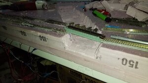

Starting to get some kind of plan to do the logging track up the mountain. Just using the foam to give me a gauge on the incline. In the photo it seems that i need more in the top and less in the middle of the incline. I'll figure it out someway. a shot below to let you see the ramping

I made a ramp for the mountain track. Working with foam cut to fit. I have it close. Got to clean the track and run a engine and cars up it to see if i missed something. Seems i always miss something.
