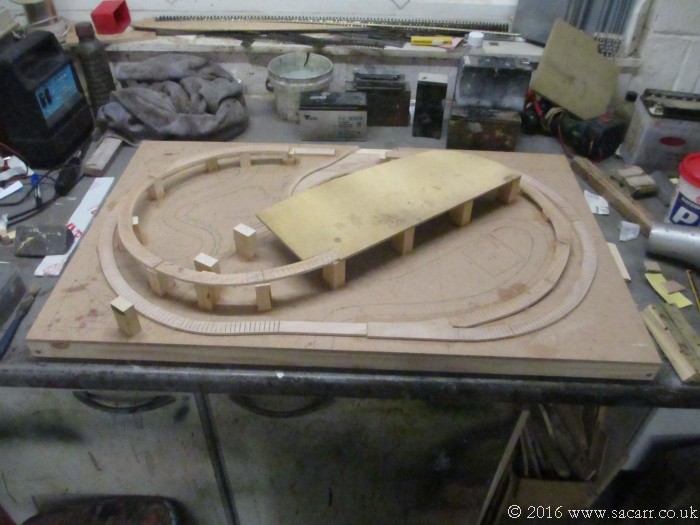

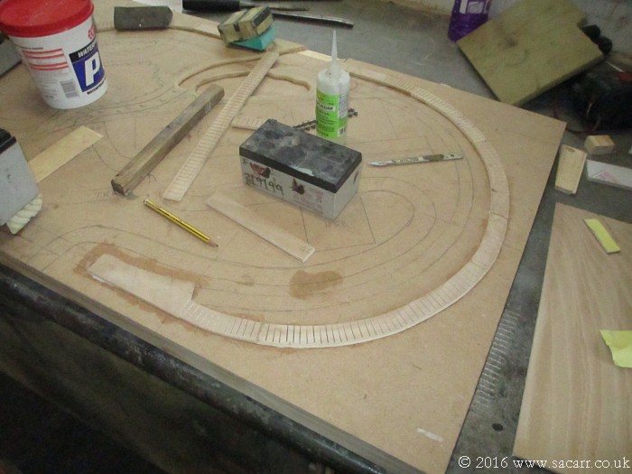

With the river area done, we moved onto the track bed. This was to be raised up slightly from the baseboard, and I cut a number of strips of 1/8 ply wood which were glued down.
To allow the ply to curve, a number of slots were cut into the strip on the bandsaw. It was then glued and weighted down to dry.
After testing the two locos we had on a test track incline, we began elevating the inner track bed, on its way up to the station.

The backscene was fitted today. It is made from two sheets of 1/8 Hardboard, with both rough sides glued together to help hold the curve in the backscene. It is also glued to the raised platform that will support the station and buildings. This was a job I did on my own, as it was quite a difficult operation forming and clamping the sheets together.

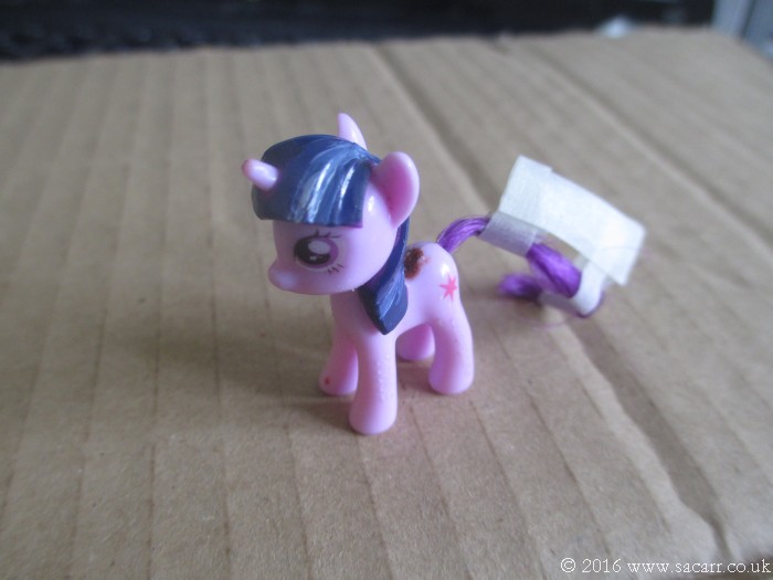

I started re-painting the spare ponies today after the model shop trip. This is Amethyst Star, converted from a Twilight Sparkle with the pegasus wings removed. Only the mane has had a base coat so far.
This is the first coat of white on Rarity, also converted from a Twilight Sparkle.

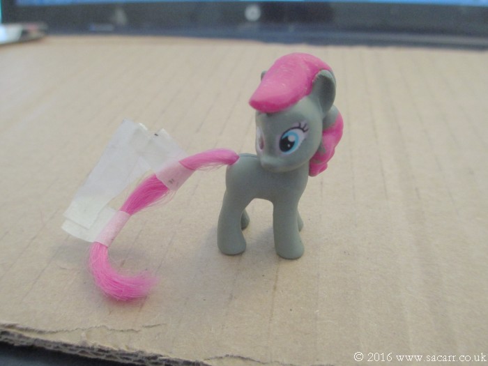

This is Minty, converted from a spare Pinkie Pie. Her mane was trimmed and re-shaped to more closely match Minty. The green dried a bit dark, so a second coat will be mixed to a lighter shade of mint green.

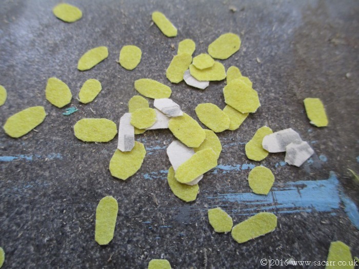

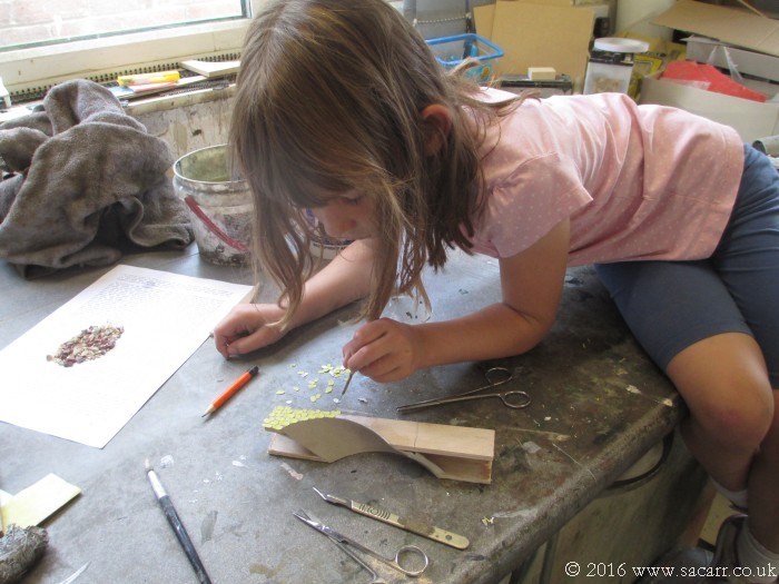

While the PVA was drying, we began to cut some 120 grit sandpaper into stone shapes to clad the wooden bridge structure I'd made the day before.
Using the tip of a scalpel to pick them up, they were placed onto the bridge, which had been painted with a slightly dilute PVA glue mix, mainly to slow down the setting time in the hot weather. The layers of 'stones' were slowly built up and then the first side left to dry.
The first side of the bridge is done, and once dry, the overhanging edges were trimmed.

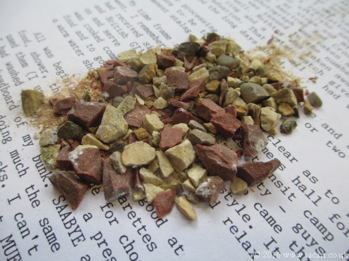

While that was drying, we went into the garden to look for some stones for the river. A few larger pebbles were smashed up with a hammer to create some nice sized rocks for around the river, waterfall and bog.
