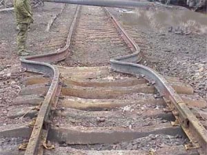

Ken , watching your videos it seems that you got your kinked trackwork fixed . The ride looked very smooth . What was the final solution you came up with to prevent that from happening again? Your layout is fantastic !!! Something to be proud of for sure .
The kinks are handled pretty much the same as the real railroads handle them with loosening then ties, move them over a bit then secure them again.
do you also cut a gap in the track for expansion , or do you think something else caused this?
After the roadbed was built and the track laid, I turned to work on the signal system which gave the wood the time it needed to settle. A lot of kinks showed up in the trackwork that had to be fixed. Just a matter of cutting the track to relieve the pressure. I think all the wood has pretty much settled. The ballast also helps to lock the track onto the roadbed so there shouldn't be anymore problems.
