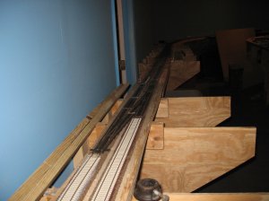

With the summer outdoor projects demanding attention along with the weekly chores, i.e. cutting the grass, work on the D&J Railroad has slowed down significantly.
With the recent week of rain I was able to put some time into laying more track. No power is applied to the rails yet, but I can run a string of cars on each track to ensure smooth action.
The 2x4s on each side of the road bed are the foundation of a mountain that will cover this section of the track. A tunnel portal will be right about here.
5438
Looking down the track from this perspective will be looking into a tunnel at about this point. The 2x4s are where the end of the tunnel will be. The lower road bed is where this track passes under itself about 40' around the loop.

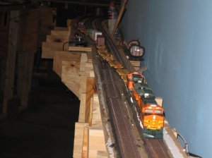

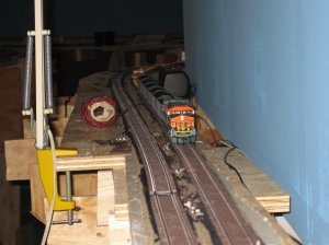

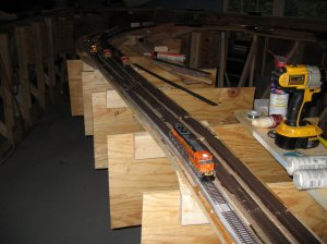

This is one of the first trains to actually run on digital power on the new D&J Railroad. Each section of flex track will be linked to a power buss under the roadbed. This will provide the perfect electrical connection that is necessary for a good running layout. The white and black power buss can be seen laying to the right of the track, down on the benchwork.
Testing the track and making adjustments. It seems that flaws in the track work are more evident with a train on it. The benchwork design makes adjustments quite easy. Here is a cut of 16 autoracks on the left most loop. The locos are on the track that has soldered leads. The tail of the train is on track that is powered only by the track connectors. The motive power is a BLI AC6000 BNSF and an Atlas GP35 SP, both MUd together. The train is on a 1% grade going uphill.

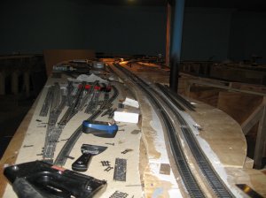

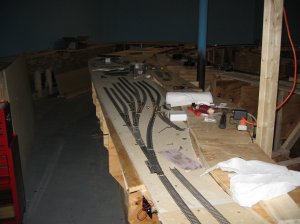

Getting some work done on the yard. The yard will make a slight right turn and then come back together on the distant yard lead. The mainline will be on the benchwork on the right edge of this picture, where the paper towel roll is.
5467
The yard lead
5470
and the loop going into the yard. The end of the cork roadbed for the yard lead is at the bottom of the picture.
5466
The wiring is moving along two peninsulas to the left of this picture. I have started blocking the tracks for the coming signal system.
Got some more wiring done to the yard lead and the right most loop of the layout. The left most track is the yard lead with a cut over to the mainline so trains coming out of the yard can get around trains coming into the yard on the track that the SD70Ace (foremost loco0 is sitting on. That section of yard lead is about 45 feet from the cut over to where it terminates further down the mainline. The other end, behind the locomotives leads to the main yard.
All three Digitrax command stations are now synced and controlling their own sections of the layout. Adding more buss line and soldering each section of track to the buss is taking some time and patience.

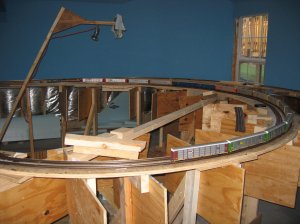

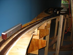

I finished installing the cut over at the first yard lead so the right most track could have access to the yard. This is about 45 feet further down the track from the previous post picture. The spine train is snaking from the yard lead across track three to track two and will be left hand running up the 1% grade to the mountain pass (yet to be named.) Each turnout is a #10 as you can see the entire 5 spine cars are in transition. The two turnouts on the mainline will be powered by Tortus machines. With these turnouts and the two in the previous post completed, I can progress with laying cork and track to complete the mainline run of the entire circuit. That will be about 1 more scale mile.

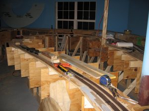

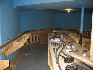

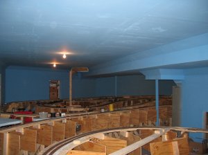

Looking across the basement and the three peninsulas of the layout from the top left to the bottom right of the layout illustration in post 10 of this thread. The cork roadbed is almost into the far corner with just about a 1/2 mile left while the track is just up to the lift out section that crosses in front of the door opening going into the storage room. The thing standing up in the distance is a lamp system for working on the yard turnouts and wiring. The Digitrax command station in the foreground powers the center loop and over to the door way and back justpast the camera to the left. If you look, real close between the pole and the central air system to the right side of the picture, you can see a AC6000 BNSF sitting on the track. Kinda brings a bit of perspective of how large this layout is. The ceiling is 9 feet high.
5494

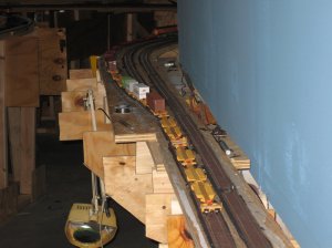

This is a little closer look at the line of cork roadbed that is in the distance in the previous photo. The yard is on the right. The double track mainline will curve to the right along the distant wall then come back toward the camera to the right side of the yard.
Finally got the mainline laid down where it passes the freight yard.

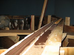

This is the lift out section in front of the storage room door. Note the #10 cross over just before the lift-out section. The freight yard lead track will join into the mainline on the other side of the lift-out and the crossover in the foreground will get the trains over to right hand running. The track in the foreground is concrete ties, code 83.
