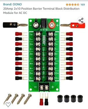

Good morning all,
Question for you. I bought this terminal block recently. Can I just use a power pack to power this block? If so, what output would I need? I plan on powering a few smaller lights for buildings. Right now, the power packs I have are 12 volts output.
Thanks for any advice.
Thanks,
Matt

A 12v-16v wall wart/power pack would be fine, just ensure if using LED's/SMD's to add correct resistors to them.
Any DC power supply will work. For LED's, 5v or 12v will work jut fine. Use a 470 ohm resistor for 5v or a 1000 ohm resistor for 12v in series with the LED.

I don't have a link for the resistors, but any 1000 ohm 1/8 or 1/4 watt will work. Amazon has kits that come in many different values .If you want your LED a little dimmer, you can go up in value to 2000 or 4000 ohms or higher. For a brighter LED you can go down as low as 560 ohms.
Yes, then insulate the wires so you don't get a short circuit.
20 second job and your done.

You could, but definitely not recommended, it's simply not a safe way to do it, also you may want to add further lighting at a later date (building or more street lights or something else that needs 12v), so much easier and safer to use a Distribution Board from your LHS or Amazon (their around $5.00), something like this one (I have 4 of them) is ideal .
As you can see this has a socket that your wall wart plugs directly into, or you wire in directly via the two screw-in points next to it.
