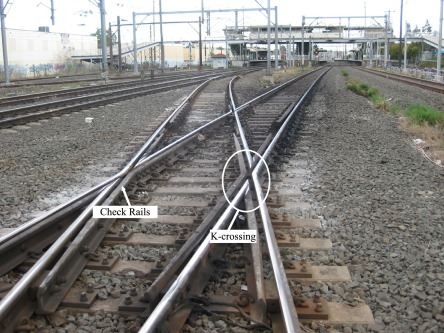

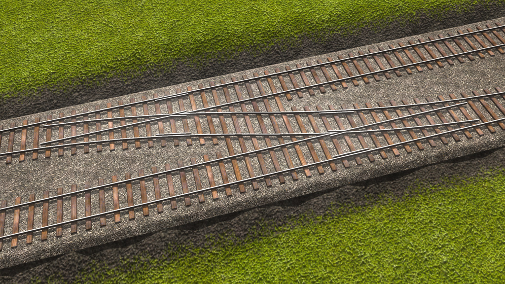

What we are talking about here
a single crossover between to tracks
A double crossover, which incorporates a crossing at it's center, also known as a Scissor crossover
The first one is a "crossing" (at grade). The next two are crossovers (between parallel tracks).

As is the case of streets and highways, a 'crossing' involves an intersection at defined and unchanging angles where the two or more routes do not deviate from their axes of advancement, and where those routes resume their axis of advancement on the other side of the crossing.
A 'crossover' is where one changes paths or axis, being a transition from one path to another path. When through the crossover, the routes are still on an adjacent and parallel path...such as twinned tracks between two destinations. It is akin to changing lanes on a highway or a street.
On the other hand, an 'overpass' is where one route crosses over another, but at a substantially different height so as to accommodate clearances of the vehicles passing under the overpass.
