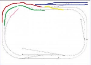

Alright, what do you think of this?
I think it could use a few changes. First if that is supposed to be a "yard" on the upper right make it a yard (blue). It would be more interesting if the main loops weren't so symetrical. I would use the space on the upper left to give it some "swoosh" (green and red). That would dictate moving the crossover (yellow). That would also allow the siding on the upper left to be longer (pink).
Ah, thank you for the advice Iron Horseman, I will do that. That does look much better.

I like those ideas, thanks Tony. I think I will incorporate some of that too. I would agree that my plan does look a little too symmetrical which is mostly due to my lack of experience using SCARM. Also, since I can't draw out the blank space in the middle of the layout for operating in, I should note that each side of the layout is planned for 16" width, maybe 18".

Of course you could also tilt the whole thing just a tiny bit such that the parallel tracks are not also parallel with the edges of the layout space. I did that on this small 3.5'x5' and made it look so much better.
