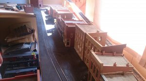

Here are some walk round photos of my layout at the moment, starting from the entrance from the lower level staging yard at the bottom right of the track plan.
trains enter the layout from the lower level, travel round the layout through the town and back into the industrial area, after that the road power is detached and parked up, the local switcher sorts the cars, makes up a return train the the road power reattaches to the consist, this then departs goes round the layout through the town again then goes back into the low level staging.
You're making some great progress there. Things are looking really good. I see you have a bit of work to do on the downtown buildings. Just finished a bunch myself and I will give you a bit of sympathy on those upcoming projects. Keep the pictures coming. I wish I had the time to get down to the train room and get some work done but I just have too many things going on during the summer months. We have to make up for the long Montana winters.
I can only really get on my railroad shed at nights at the moment, we actually have hot weather this summer! I need to add some more ventilation to make a through draft.
Every part of my layout and buildings need a lot if work, just trying to get the basics done first then I can concentrate on specific things.
I am most looking forward to getting the main street done, although it is quite daunting thinking of all the shop insides I need to do along with the lighting.

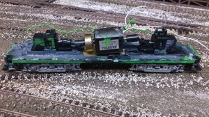

Another project I am working on is a rebuild of an old AHM C415, I am going to build a new chassis from brass to add weight, change from high cab to medium cab add hi-ad trucks, new motor with flywheels.
And I am sure by the time I am finished someone will release a new model of one...

A couple photos of the start of the chassis.
Still need to do a lot if work on it and properly mount the motor (it is just placed there for photo). I will be adding as much weight as I can to help traction and running.
That is looking like it is coming close to running and the body going to the paint shop. I appreciate the offer. I would like one, but right now I really have more locomotives than I can really use. Some are nothing but siding queens. With a switching layout, a lot of power is not really needed.
