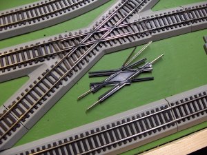

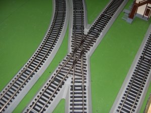

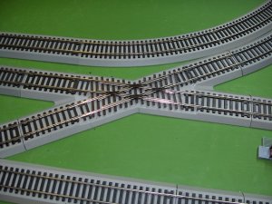

The attached pix show the finished project and the old frog next to the new one shows the difference. I wish I had taken a couple of shots showing the steps outlined above, but I didn't think about it until it was all back together and operable.
