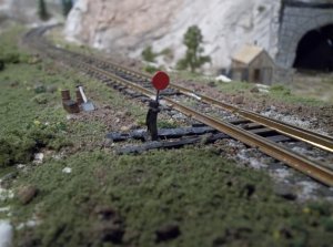

I have been over this section of scenery several times, started with the dirt only. A couple months later added more dirt and watered glue. The base is sheet rock compound.
Later yet I added the fine turf and a few clumps of some other bushy stuff, can't remember what it was called. Then added something with green and yellow looks kind of like dandilions. Now I kind of like the way it looks, took a few months, though:
