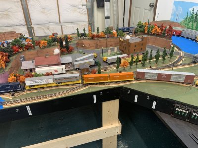

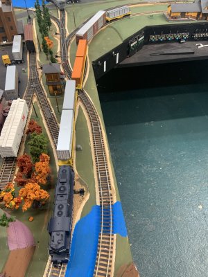

I never thought it possible, but just a couple small mods and these guys make all of the curves and even this “S” curve crossing with no derailments. These cars are Athearn Blue Box

Athearn Blue Box cars can do just about anything! We had a forum member known as new guy who would run them with one truck on one track, and the trailing truck on a parallel track.
Those couplers look like they're almost sticking out at the corner of the box car.

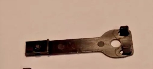

Yup. The coupler box is mounted to this:
The ones I had suffered from coupler droop from the length of the drawbar. I ended up fabbing and installing supports on either end of the car for the drawbar to ride on. The support was a piece of stiff brass wire with a 90 degree bend on each end, drilled a hole in the deck of the car,inserted the wire through the deck, and glued in place. Some flat black paint allowed it to blend in.
