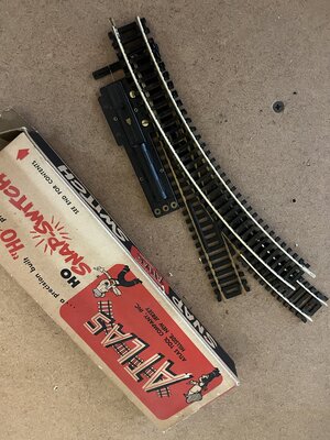

I finally found an Atlas Snap Switch to show what I mean in post #12. This is what it looks like when you line the 18" radius curve up with the diverging route that includes the 1/3 18" piece. Note the short section of straight track at the beginning.
Substituting it in for the piece of 18" curve only works at the beginning or end of the loop. If inserted any other place, it makes a greater diameter half circle.
That shows it much better than my zillion word explanation.
