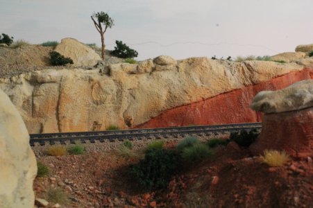

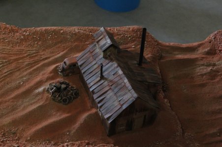

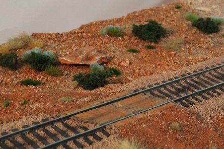

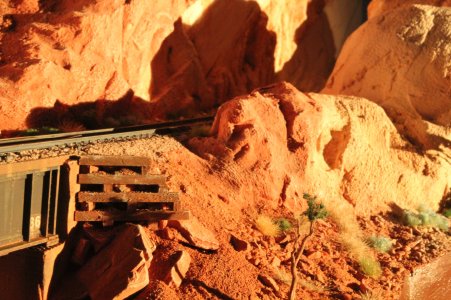

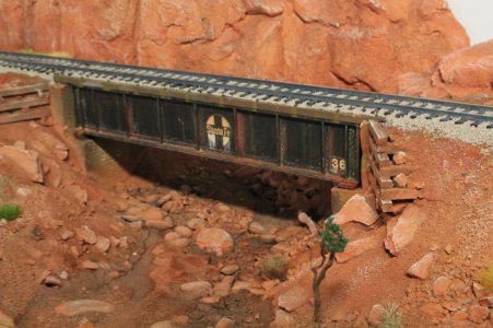

Hi ! Concerning ground cover I don't use dirt, I prefer crushed sand. I get it from a gravel pit (quarries should be ok), I fill a bucket for a
small amount, sometimes free. I also get a mix of "pebble" type stones I use in creek beds to simulate water eroded rocks.
I don't bake it, when it's dry I screen it to different sizes. I like to screen the finest through a stocking to obtain a very thin powder.
While screening I remove any dead bugs, twigs, and so on.
I spread white carpenter glue on the carved foam terrain. Then I cover with different sand sizes with stones added.
Later on I come back with a pipette to wet everything with alcohol or water with dishwashing detergent added. Then a 50/50 mix of glue, water and again a few drops of dishwashing detergent.
When set it is like concrete. The drawback is that an airbrush is necessary to color the finished terrain, I use gouache (water colors).
Sand is great because it naturally flows down inclines, around rocks, and also great to make drifts.
I use the "powder" type for dirt roads, since it's very light I rather spread it over the wet glue saturated sand, and vacuum the excess when
glue has set.
As a last step I like to drybrush the terrain to make stones and grains of sand stand out, having a more individual look. It might seem
tedious, but it's worth it.
