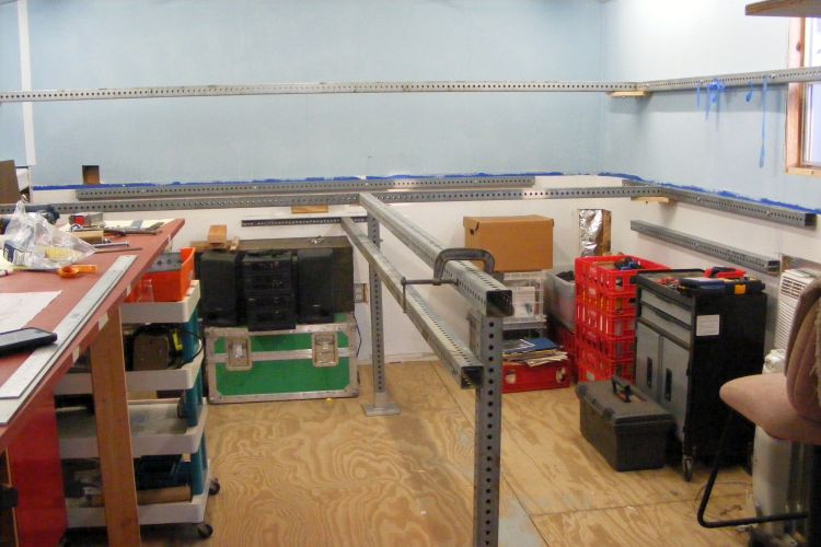

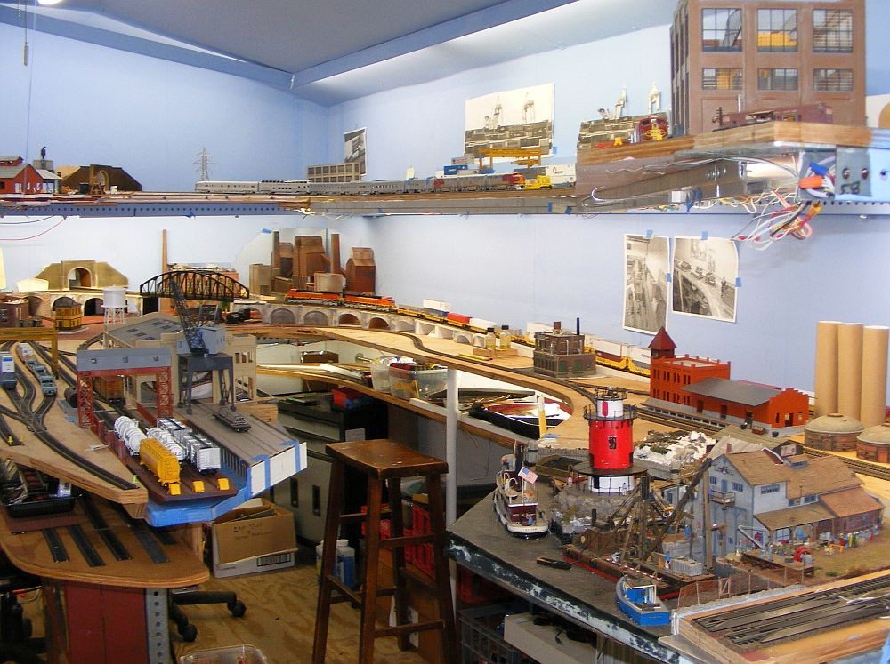

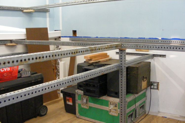

While you state it is cantilevered, it is not, and this may be some of the confusion on the other forum. The front edge of the plywood is supported by the metal framework. A cantilevered installation would have NO framework of any kind supporting the front edges. Cantilevered means it is only fixed/supported at one end. Most shelves have some amount of cantilever, if the shelf bracket doesn't extend all the way to the front edge of the shelf. The part of the shelf (wood) that is unsupported from the front of the bracket to the front edge of the shelf would be considered cantilevered.I didn't care for all that wooden structure to support the decks on which i would be laying my track. I found some metal beams I attached to the studs in my wall system, then cantilevered the 3/4 plywood decks off of that .
Yes and that metal framing at the aisle makes it NOT cantilevered. Just because the metal tubes allow for few vertical supports has nothing to do with whether the plywood is cantilevered or not. Places that might be cantilevered is edge of the steel mill and the peninsula I can't see where the horizontal metal tubing runs under those sections.If you look closely at my benchwork you would find some horizontal metal pieces on the aisle edges of the plywood decks, protecting an keeping the plywood from distortion bending. But there are VERY few vertical support pieces. It is primarily 3/4 plywood bolted to the metal beams along the walls, then cantilevered out toward the aisles
