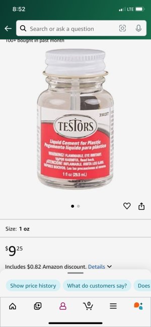

Liquid model cement sold by Testors and Plastruct are 100% MEK (methylethylketone). MEK is sold at local hardware stores for $15 a quart vs $10 for 1oz and $13 for 2oz. That's 47 cents per ounce in the quart can. I've accidentally knocked over my bottle of Plastruct at least 3 times in the past year.
I do the same, keep it in a glass bottle. I usually add about 20-30% acetone to the MEK.
